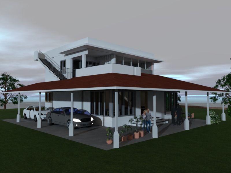

I then add some sketch render channels and do a bit of photoshop watercolour effects + desaturating of colours etc and get results as below.
These are our typical renders that need to be reproduced often for the client when design changes are made. It takes max. 5 minutes to do, and by using layer effects in photoshop, it becomes copy + paste of a few images and merge layers down to show changes for a new render.
Might not be your preferred style of presentation, but we are happy with the results.

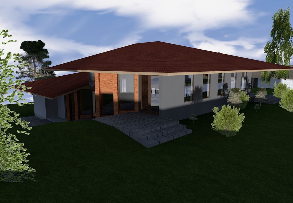

Hi
I adjusted these setting, but still the image is not correct,
where the shadow is falling na, there it is coming bright. and light effect is also not proper.
I have attached the rendered image

My guess would be that all those spot lights etc are affecting the things you mentioned.
Try adjusting the settings for those.
Given the sugested daylight scene, you can probably dial their settings far back.
A lot of light sources also significantly increase your render times. You could turn them off completely so you only see the 3D models for the fixtures and maybe replace them with a glowing surface. This won't cast light, but will give a fake suggestion of light there.

In preview I am getting the Photorendering sky background, But in final rendering the background sky is not coming.
And I have added the general light for interior, that is also not coming in final rendering..
Am not able to get the final exterior rendering properly.
Once I save it to the folder it is showing the sky
Have attached the image

I have rendered with the same settings, But the view is not coming properly.
I don't know from where this shadow is casting.
Help me please

Something behind the camera or above the model in the air somewhere, would be my guess.

no I have placed the marquee and taken to the 3D, but still it is coming,
I have attached the recent image in the top, layout opt 2.
In that also it is coming black

If you haven't placed a camera yet to be able to return to your preferred position in 3D, do so first. After that, right click the mouse and pick 'Fit in Window'. This will show you your entire 3D model and you should be able to see what is casting shadow in the foreground.
