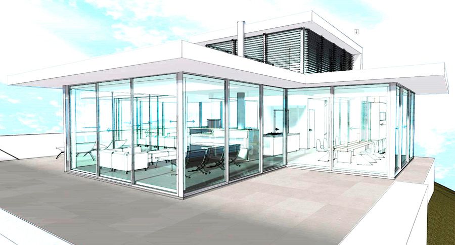

__archiben
combination of sketch render, lightworks render and layer blending in photoshop. (i forgot to turn the door/window opening arrows off in 3D though )
~/archiben
[edit]for some reason, the preview of this image appears as a blue smudge?! click through and it's in full colour. is it just me? (safari 3 beta) or is there some kind of new preview tech in operation here admins?[/edit]
and being pedantic there is your mouse pointer visible in right upper corner - just above those louvres...
you should pay more attention to the detail mate...
nope, the thumbnail looks crappy on Firefox.6/win too.

__archiben
yeah yeah. you can take the boy out of england... eh?
