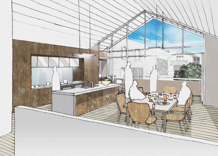

Hi DG - Thank you for the reply. Those links actually only show how to use the sketch feature. What I don't see is a way to achieve a colored sketch. I find the regular sketch feature pretty intuitive to use though, just wish theres was a colored sketch option. Thank you for sharing.

Thanks Erwin - I found another video on YouTube last night by Shoegnome which uses a pretty quick and simple method of creating a B/W sketch first and and then another fast color rendering using the "internal engine" option and then merging the two images together in Photoshop. It's just strange to me that with everything this program does it cannot produce a colored sketch on it's own...strange. It's funny though I'm learning as I go that it does do quite a lot but it does not do some of the most basic things 😉 The video I found is here:

Sketch render takes less than a minute though, so it is hardly extra effort. I generally do a bit of photoshop anyway to desaturate colours a bit and do some vignetting.
Sketch lines help me define the edges a bit in renders and suggest a bit more illustration, which I prefer over suggesting photo realism to the point where client might feel he can't engage in discussion about the design.
Internal rendering can actually take more time than a fast physical render (with a few tweaks for glass surfaces), but that might be my (old!) Xeon processors that are more at home with cinerender than the old internal engine.
