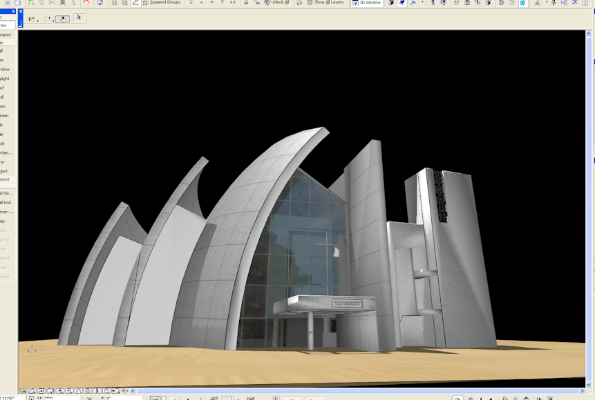

Here is a sketchup model, opened in Artlantis, exported as .obj to 3dmax, saved as .3ds, converted to .gsm in ArchiCAD. It made the trip ok.
