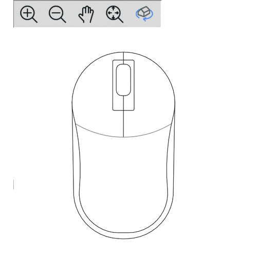

Images for animated GIFs can be created with 3D Views, 3D Documents or 2D elements placed on Layouts. In the first two options placing a Camera or saving the current Zoom in the View Settings / 2D/3D Documenting / Zooming (don't forget to uncheck 'Ignore Zoom and Rotation when opening this View') makes sure that viewpoint remains the same. If you want to work with 2D elements the usage of  Trace and Reference can be a great help in placing the elements in the right position.

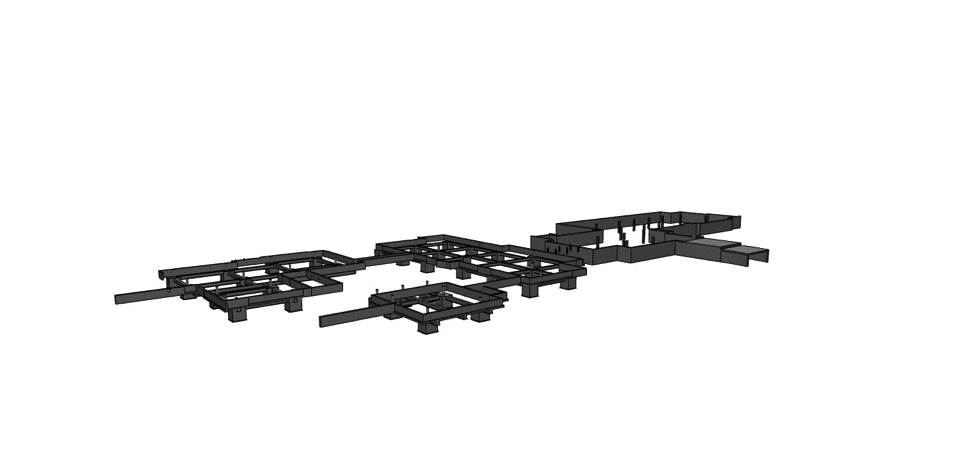

    • For the first View do the following settings:
      • Change the Partial Display Structure to 'Core of Load-Bearing Elements Only'
      • Select the proper Graphic Override Combinations
      • Use the Layer Combinations
      • Activate the Filter and Cut Elements in 3D and change the option 'Stories to Show in 3D' to 'Limited' and set the required range. (example: From: Basement, To: Basement). Check the 'Trim Elements to Story range' as well.
      • Save the View
    • Repeat this workflow for all the other stories but with a different Story range (example: From: Basement, To: Ground Floor, then To: First Floor and so on)

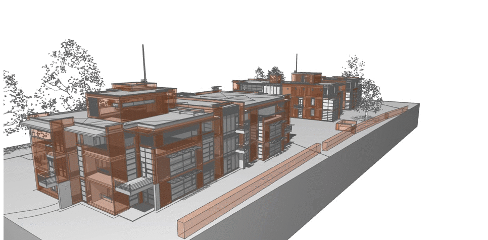

Renovation Process
  1. Define the Renovation Status of elements
  2. Create the 3D Views
    • Set up a 3D Floor Plan using the Axonometry  Top View (Tip: use the 'Look to Perpendicular of Clicked Surface' command)
    • Cut the 3D model using 3D Cutaway
    • Save Views with different Renovation Filters
  3. Set up the Publisher Set
  4. Create an animated GIF in a GIF maker application
