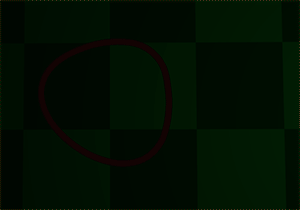

how can i make linelight like halo? guide me perfectly and with details,please.

As explained on pages 140 -142 of the book LightWorks in Archicad, now on Clearance, neon with LightWorks is complex.
The neon tube itself must be made of a material that appears to glow and an array of closely-spaced low powered general lights creates the emission.
Click image to play the animation
