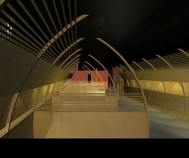

I'm planning restaurant interior.
I'd like to bring some atmosphere environment with warm character from wood material.
But the rendering looks quite stupid.
Cann you please help me?
For effect: no sunlight, no camera light, ambient light 50%
used lamps: downlight for small lamps, 5x sun object with 5% and yellow color, window light for the lighting wall 10% and yellow color

I put this time LW-shader for material.
General light 33%, Falloff 2, as Dwight said.
The wood looks bad. What kind of lw-shader can I use for wood material, for better result?

post an isometric view of your lighting solution.
Dwight Atkinson
Here is iso picture.
I send to you also ground plan.
Here is ground plan with light position.

How is the wood supposed to look?

Please clarify the plan. Whatever the overlap, I can see several sun objects.
Duh.
This must take forever to render.
Try two large light cone down light sources instead.

That is ground plan.
sun object 5% and 16%
general light 33%, Falloff 2
and for wood such like pattern?
http://www.osmosis.com.au/visualize/papershop_01.htm
I put two light cone (in General 9 in Library) at 30% intensity.
I switched off the shadow, but very strong shadow!!
and too dark... not kind atmosphere
Dwight
Dropload your file to me:
http://www.dropload.com/
to:
dwight_atkinson@telus.net
and I will work on it.
