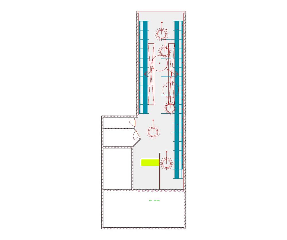

I send to you also ground plan.
Here is ground plan with light position.

Please clarify the plan. Whatever the overlap, I can see several sun objects.
Duh.
This must take forever to render.
Try two large light cone down light sources instead.

That is ground plan.
sun object 5% and 16%
general light 33%, Falloff 2
