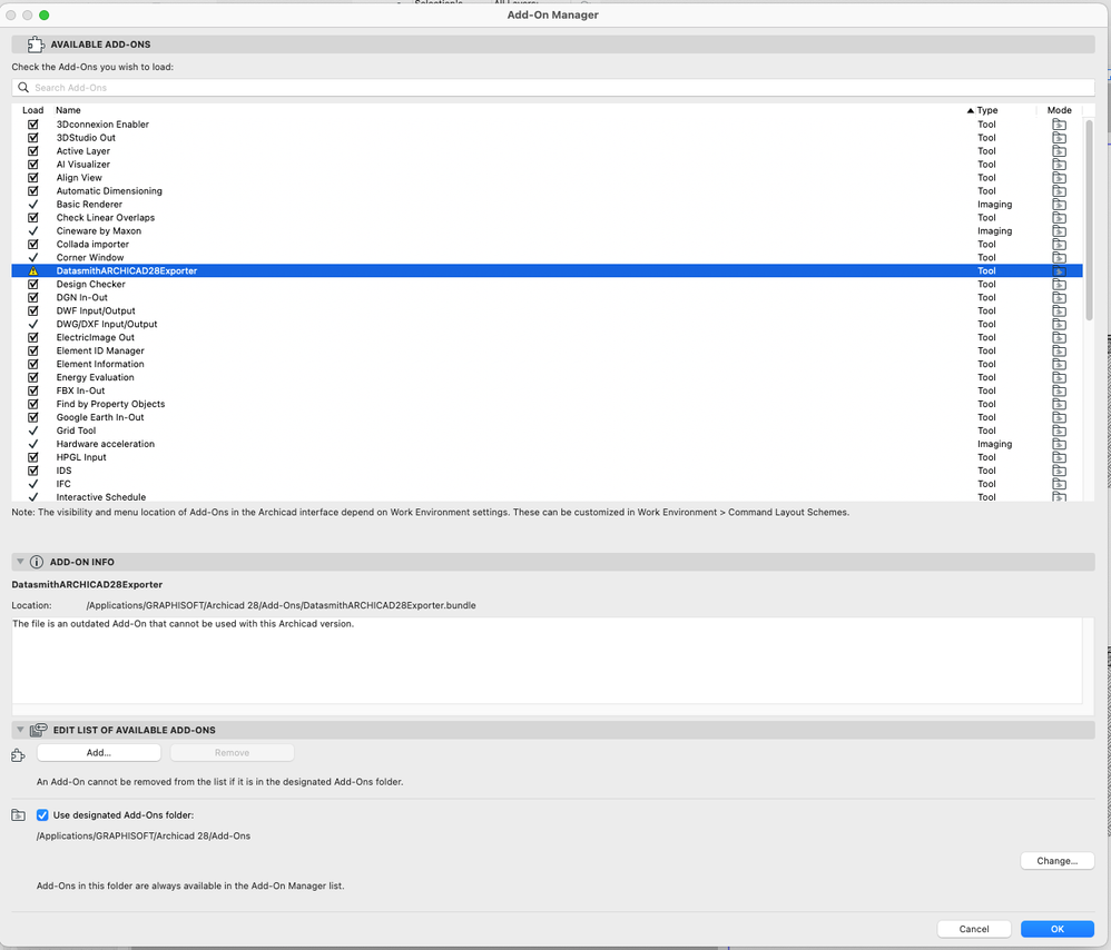

I am having an issue with the Twinmotion DATASMITH ADD-ON for AC28. It was working and now isn't (not loading at all). I have uninstalled and reloaded the ADD-ON along with AC itself with no success
The ADD-ON manager shows two versions that keeps reappearing even after I delete them, they show the following:
- The Add-On is already loaded.
and the other
- The file is an outdated Add-On that cannot be used with this Archicad version.
Any suggestions would be appreciated.

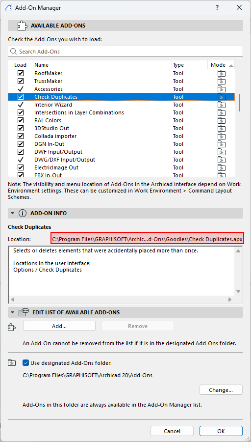

Hi!
It can happen that you have 2 of the same Add-On installed, and e.g. that the broken one (or some old one) blocks the new Add-On.
Try the following:
1. Open the Add-On Manager
2. Select the faulty Add-On
3. Check the path like highlighted here:
4. Note the paths for all of the Datasmith Add-Ons appearing in the Add-On Manager
5. Close Archicad
6. Delete all Datasmith Add-Ons for which you've noted the path
7. Open Archicad & confirm that no Datasmith Add-Ons are loaded
8. Close Archicad
9. Install the Datasmith Add-On
10. Open Archicad and see if it works now
Hope that helps,
Bernd

FMA01
Hi Bernd,
Thanks for this!
I tried this but it didn't work, although I think the issue is similar to what you are suggesting.
Current error screenshot attached.
Thanks,
Fraser
Hi Fraser,
Very weird... What's your exact AC28 version?
Automating Archicad with Add-Ons, GDL-Objects & Python Archi-XT.com
FMA01
Hi Bernd,
Thanks very much for getting back to me!
I have solved the issue, it was a matter of upgrading to the latest macOS.
Cheers,
Fraser
