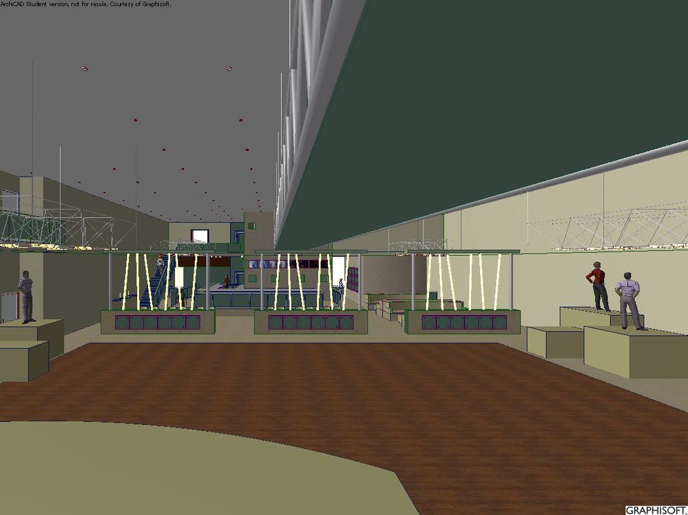

please post a screen shot of your project to assess complexity.
Dwight Atkinson
Good Morning,
Please see attached a .jpg file.
Thank you.
