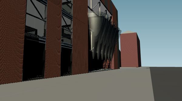

My light objects, including general lights (like spot light), and light fittings are rendering with weird grey blobs where the light cone is. The grey 'blobs'are not in the shape of the lite cone, a bit more random... and in one render, an identical light will have a grey blob, and another will render perfectly.
ps using lightworks engine

Please attach a screenshot so we can better understand what you are seeing.

I am having the exact same problem.

In parametersetting, turn of "Show 3d lightcone" or what the specific objects parametername is.
