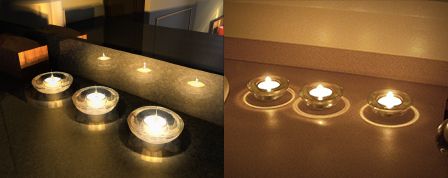

You'll never get glare like the photoshop flare...
This image is done with some diffuse glow in photoshop - the candle flame is light over.
