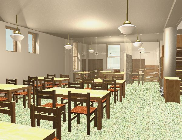

Here's an exterior rendering with the undersun off.
