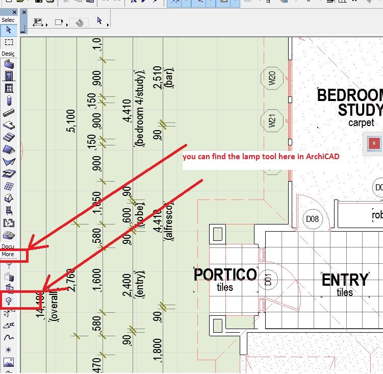

Where can I find the Lamp Tool in ArchiCad 16? It does not show up in the ToolBox..
Srinivas
Did you check it here?
www.bimvizstudio.com
ArchiCAD Service
ArchiCAD since v9 to latest
Mac, Windows 11
