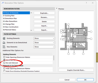

Line to differentiate two different cut fills (done by graphic override) of the same wall type
I have a wall that is next to a wall with a different cut fill (it is an extension of an existing wall, into a new wall).
Is there a way for a line to show in between the old and the new?
12 Replies 12
You have to choose the 'Do not intersect' option in the renovation filter settings.

We generally have several version of the 'same' building material. With a high priority if it has a structural function, lower if it has a non-structural function and in the case of renovation projects we will add 'existing' versions of the building materials for the 'existing' part of the model. This solves this issue, as the new wall will have a different building material (even if the real-world material would be the same).
