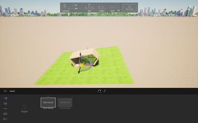

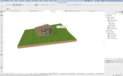

I hope this tip can help import files from Archicad 25 to Twinmotion using the Datasmith Direct Link.
1 - In Twinmotion choose Import > Import Direct Link > Your Source > Archicad Project
2 - In Archicad goes to Windows >  Palletes > Datasmith to synchronize the file.Screen Shot 2021-09-13 at 12.00.13.pngScreen Shot 2021-09-13 at 12.00.36.pngScreen Shot 2021-09-13 at 12.00.50.pngScreen Shot 2021-09-13 at 12.01.38.pngScreen Shot 2021-09-13 at 12.01.59.pngScreen Shot 2021-09-13 at 12.06.30.png

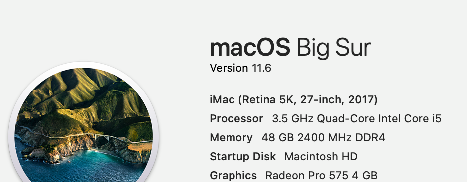

Hello,
I have a problem with the synchronization between Archicad 25 and Twinmotion 2021.
The synchronization between the two programs has not worked for a week. When opening the udatasmith file and checking "import direct link", "Your source", Archicad does not appear, you cannot choose any option either.
Attached photos.
Can you help me?Screen Shot 2021-12-13 at 9.51.03 AM.pngScreen Shot 2021-12-13 at 9.51.08 AM.pngScreen Shot 2021-12-13 at 9.52.09 AM.pngScreen Shot 2021-12-13 at 9.52.19 AM.pngScreen Shot 2021-12-13 at 9.56.33 AM.png
