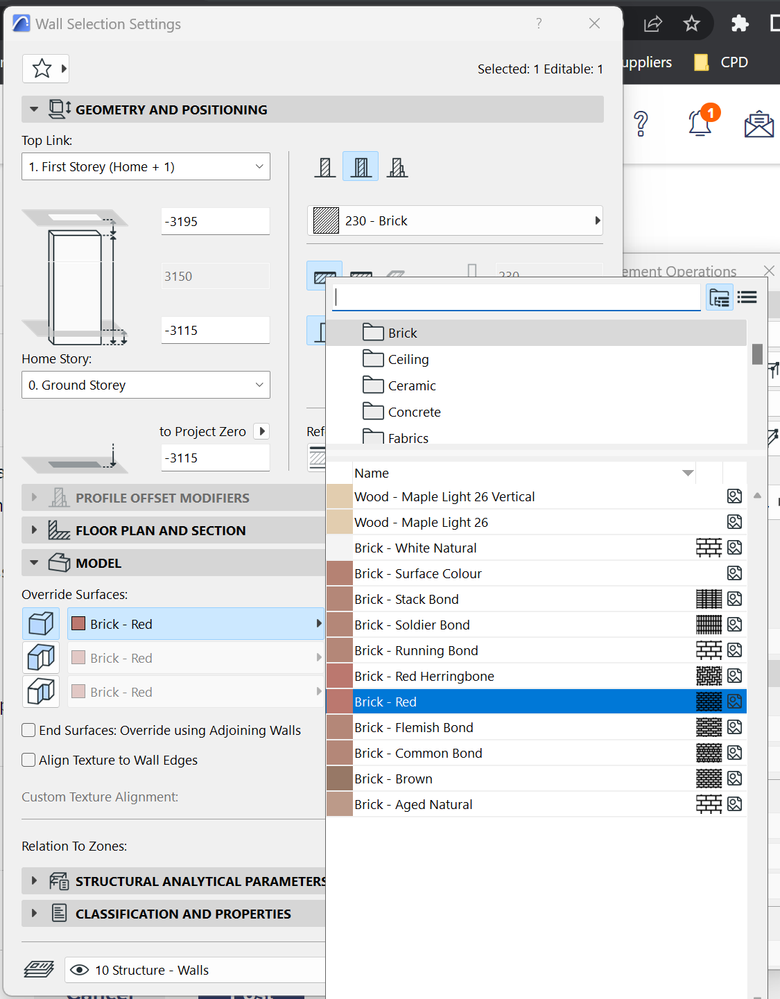

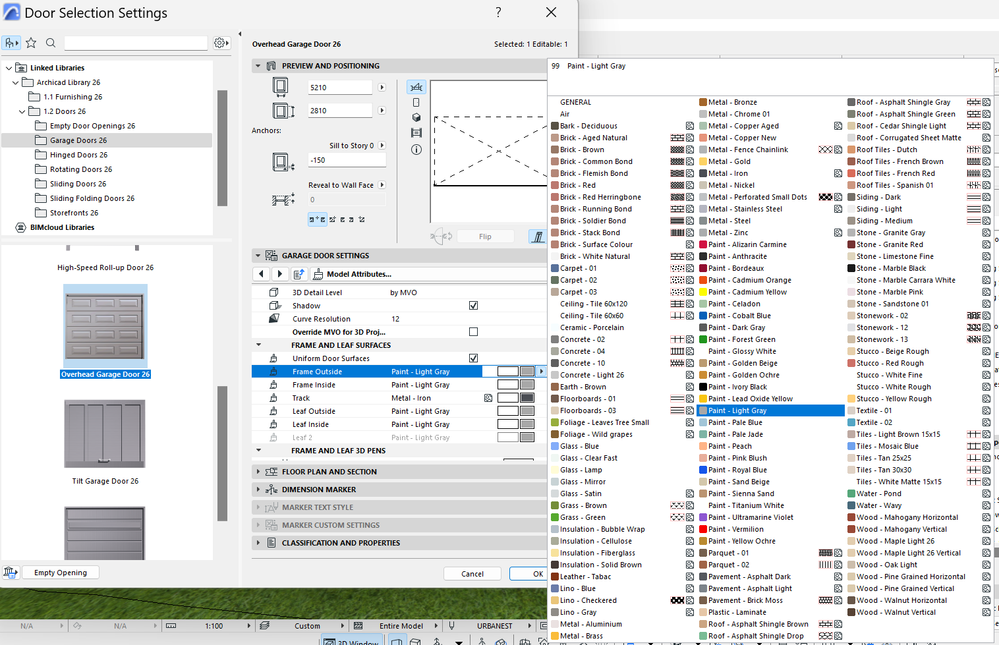

The new surface selection dialog, which allows you to search for a specific surface by typing in the name, is a good addition to Archicad 26 for windows users (I realise its been standard with Mac for a while).
However, strangely, it does not seem to have been rolled out consistently across Archicad? There's certain items that will display the new dialog (for example, choosing a wall surface). However, for other items (like choosing a door surface) it still uses the old dialog box. I notice this quite regularly.
This seems like something that should be corrected. Please can you assist and provide a fix to this, Graphisoft?
1 Reply 1
clints
I've noticed the same. It will display one way when I use command "T" to pull up the object, but if I do it through the palates, then it's the other display. Consistency would be wonderful.
