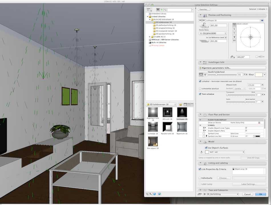

As you can see in this render I can't get shadows on the floor.
Does somebody know what the problem is?
I've been trying changing several parameters but no effect so far...
Thank you very much!

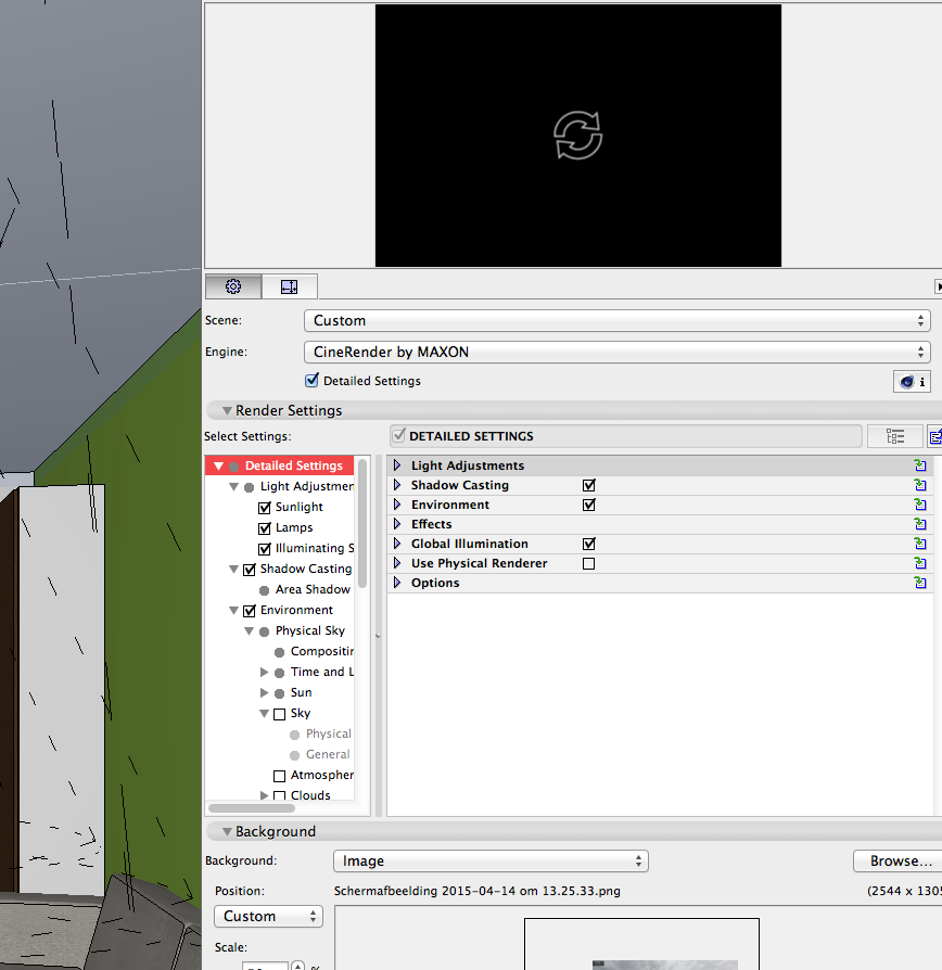

You don't say what rendering package or what version of Archicad you are using.
This will affect the answer you get.
I am assuming 18 and the built-in Cinerender.
If so have you turned your lights on and allowed for shadow casting in the photo render settings?
Hi Berry,
that's correct, it's archiCAD 18 and the built-in Cinerender.
And i've had turned on those settings
Grtz
Charlotte

OK now check the settings of your downlight objects.
Is the shadow casting turned on in the object and is the length of the light distance long enough to reach the floor?
Barry,
My light distance was 250 so I've changed it to 261 (sealing hight) but no shadows. I've even tried 270 but no shadows under the seats/table
Charlotte
David Maudlin
Rockstar
Charlotte:
Try changing "Toon schaduw" > "Transparent" from 0 to 100, I think your shadows are transparent.

Thx David,
That was the key to succes!!
