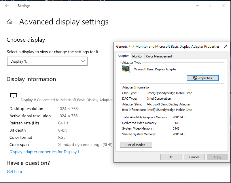

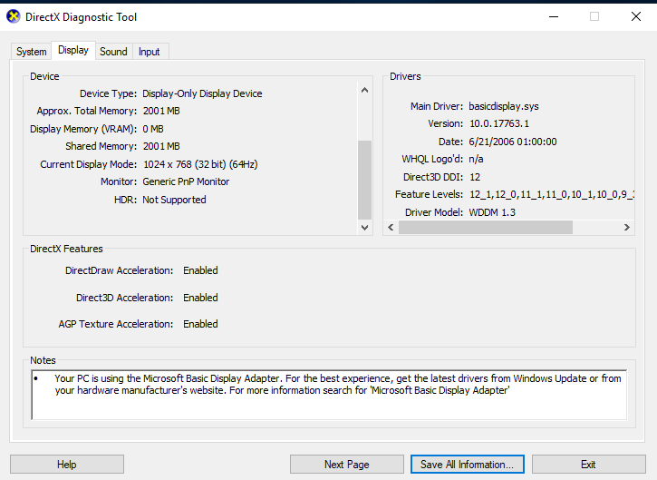

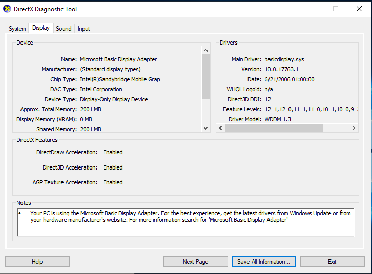

Femi
don't know if these can be useful, laptop is core i5 thoughscreeshot-3.png can be usefulscreen shot.pngscreen shot-2.png
Miha_M
You should look into the Device manager > Display adapters if anything else than the Intel (R) HD Graphics 3000 is listed there. There could be some display adapter setting in the bios / uefi interface as well. I am not a laptop user, so I can't give you more advice on this.
If there is no dedicated NVIDIA graphic adapter already present, then there has to be enough space in this laptop for such an uprgrade as most of such computers have one.
You could also search for better drivers as there is only a "basic" driver in use now.

Lingwisyer
Guru
CPU configurations are independant of GPU configurations, though generally better CPUs are paired with better GPUs. Changing out a GPU, or adding in the case of integrated, in a laptop is most likely not worth the money given the required form factor is not off the shelf... At over 10 years old, a whole new laptop would probably be cheaper than trying to source a GPU...
Ling.
From what I can find, the Toshiba satellite P755 only has the integrated mobile Intel HD graphics.
As it does not have a dedicated graphics card it will probably not run newer versions of Archicad.
As it is also quite old, you may not be able to upgrade the graphics drivers, but you could try.
Here are the recommended minimum specs to run 23 ... https://graphisoft.com/support/system_requirements/ac23
