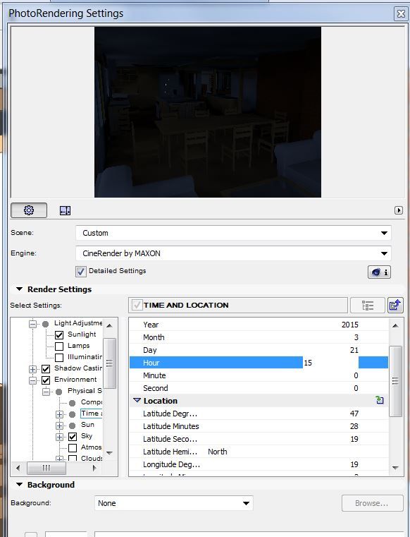

I am trying to set up several views that are photo renders so that I can place them on a sheet and do "batch" rendering of those views onto that sheet. This way I can set up all the renderings then update that sheet while I go to lunch or something. The problem is that when I set up the view and preview the render it looks one way, and then seems to change the time of day when it does the actual rendering. See image below. I have looked at every single time and date setting that I can find in ArchiCAD and I have them all set to the same date July 21 at 5pm in Wisconsin. I watched the following youtube video as my guide to this process: https://www.youtube.com/watch?v=tluXEVPayYI It seemed to work for him. I can't figure out why it's not working for me. I am using Eric Barbarow's Master template 17 if that makes any difference. I'm starting to think I should have never gone down that road. It's like trying to fix a custom motorcycle that has no stock parts. Any thoughts anyone might have would be greatly appreciated.

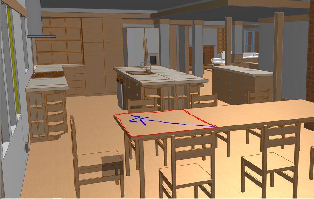

FYI I have Drawn a North Arrow into this Screen Shot as a reference to where the sun should be directed at around noon (give or take daylight savings time). I do this because strange things are happening with the time of day as well. For example when I set the Photo Render Settings Time of Day to 2 Light is streaming into the East Windows for some reason. Doesn't 2 Represent 2 in the morning? I'm sure my location settings are correct because when I check them on Google Earth it drops a marker right on top of my building.

I understand now that you can't save sun and date settings in Views (as far as I know) because if I change the sun in one camera view it seems to change it in all the others as well. Is this true?
Also, I have now decided that since I think the above is true, that I should be saving different photo render views with different photo render time and date settings. This means I would not check the box to "use ArchiCAD's sun position." Instead, setting up each view to use different saved photo render settings that have different sun settings in each one. Maybe I will start adding date and time to my saved photo render settings.

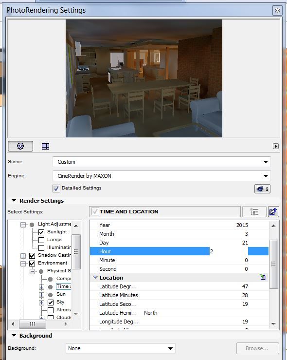

All this being said, please see the attached image, and the one to follow. They show that the sun is not doing what I would expect the sun to do. In one of them the time is 2am with a location Lattitude of 47, and the sun is shining in a SE window. In the other image it is 3pm with NW and SW windows but no sun at all.
Is this a glitch?
If so, do I fix it or just adjust my times so that they work even though they don't read correctly?

Attached another image at supposedly 3pm at Latitude 47 with windows to the NW and SW.

Anyway, I figured out that when I turned off "Use ArchiCAD's Sun Settings" (at least I think this is when it happened) the Latitude and Longitude were changed as well. So I updated those and I'm getting some light in the room as I should. What's funny is that I don't see why this worked. I only changed the Latitude by 4 degrees (which wouldn't change the lighting any where near as dramatically as it did). It seems like changing the Longitude although it changes the time the sun rises relative to GMT, it shouldn't change the time that the sun rises relative to the Longitude setting. It's probably not worth figuring out why. I should just accept that it works now and make sure that when I create new photo render settings that the location is adjusted to my site location rather than to the default ArchiCAD location.
