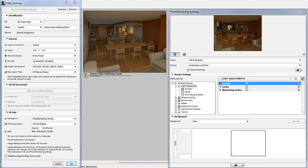

Gus
Sorry, I'm just completely lost on this. I tried what you explained as best I can but what you are describing doesn't seem to match the actual dialog all the time and when I do the next closest thing it doesn't work. I wish there were a step by step instruction manual on how to do this exactly because it's too complex when there are so many variables. View Settings, Photo Rendering Settings, Dates and Time in Photo Render Window, Date and Times in Views. Then on some of the photo renders the sun shines through the window and then others there is no sun shining through the windows at all even though it's 3 in the afternoon and on the sunny side of the house. I simply can't put any more time into trying to figure this out. Not to mention the fact that one has to wait for the image to render in order to know if it worked or not, because one of the problems is that the preview doesn't match the views version of the rendering. Here is the latest screen shot I have.

Karl Ottenstein
Moderator Emeritus
I can imagine how frustrated you are, Gus!
Your screenshot isn't showing enough, so to make life easier.. for us to check your settings... export your "VAN-kit brighter" scene settings and attach here.
If the forum will not let you attach that file type... then just zip it and post the zip. It'll be a tiny file.

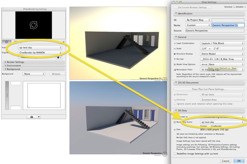

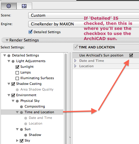

Karl Ottenstein
Moderator Emeritus
Eduardo has gone over this already, but to summarize the two places (depending on 'details' being checked) where the sun is set to use the ArchiCAD settings - vs a custom, fixed-per-scene setting....
