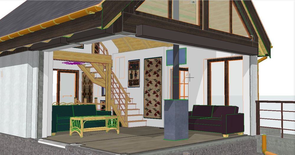

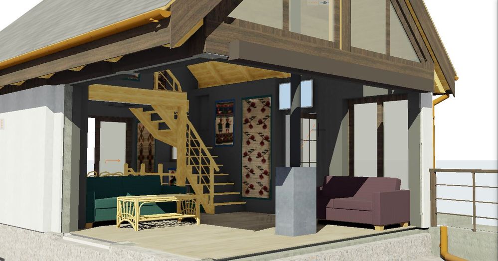

Hi everyone,
I have a generic white surface and here are the 3D views with and without the new Physically Based Rendering option. I like the softness of the new rendering option, but why the difference in color? The lights settings (sun, ambient) have not changed between these two shots - bright white, or close to. How can we control the light color?
Any thoughts?
AC27 Solo US, latest build
macOS Ventura 13.6
iMac | 3.8 GHz 8-core Intel i7 | 40 GB RAM | AMD Radeon 8 GB

Hi Roland, I wish to join those who have reservations about colors when 'Physically Based Rendering in 3D' is enabled.
Top image was generated with 'Physically Based Rendering in 3D' disabled, and the bottom one with the feature enabled.
The internal walls are Gypsum Plasterboard, Paint-Glossy White. Notice the internal white walls in the bottom image are displaying the same as the fireplace chimney pipe with Cast Iron surface. Please let us know of any improvement of this experimental feature in the future. Thanks.
