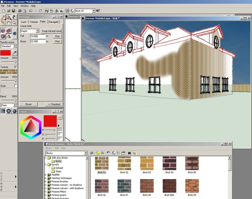

David Pacifico
I created a perspective view in AC8.1 with different colors for the "above ground" and "below ground" background.
1. In Piranesi, I am able to Paint a sky texture to the above ground background, but none to the area below. Any suggestions.
Check what you have locked. Also if you want to paint the Sky with one texture and the below the horizon with another you may need to define different colors in ArchiCAD then in Piranesi you can lock to the Color and the Depth.
How are these textures imported or attached to the Piranesi file.
For one Texture at a time: As Karl noted earlier, you can drag and drop them into the texture window, or In the Piranesi Settings Pallet go to the Textures Tab and click on the Browse.
You can also create your own Library: In the Style Browser menu, Library Menu/New/Style Library Builder.
to illustrate a Plan or Elevation view, what is the best file format to save from AC to open and render in Piranesi ?
The best, yes, would be saving those views from the 3D window as an EPIX. Consider using a a horizontal cutting plane in ArchiCAD for a Plan view. Piranesi has the ability to open other image files but then you may be having to construct pixels with depth. Where as if you made the EPIX from the ArchiCAD 3D those pixels would already have depth.
On the Mac side one still needs to go through Art.lantis or use the Vedute program that comes with Piranesi. On a side note Art.lantis and ArchiCAD seem to create the EPIX file slightly differently. For example I don't think you can import cutouts made in one and imported to the other.
