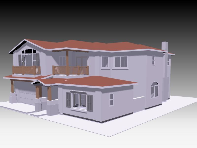

After trying to tweek the LightWorks sun, etc. etc. I became fed up with the results.
Simply exported the 3Ds format file, loaded it into the C4D r9 demo, corrected the sun position, selected radiosity and 5 min. later up pops this image. Then I used snagit to screen grab the image.
A quick in progress image for the client that I am proud enough to send. Created with a minimum of time, with a rendering engine that is basically free.
