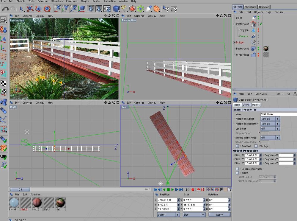

I wanted to let you know there is a helpful tool available to C4D users who want to integrate models into their background photos.
It's called, PhotoMatch.
http://www.vreel-3d.de/plugins/PhotoMatch/links.html
Attached is a screen shot of my first attempt to use the tool to simulate railings onto a bridge. I will be using this often because much of my work involves additions to residential structures. Hopefully after I fully understand it's many options I can post a helpful tips tutorial.
Here is a side by side comparision image for the Bridge Railing.
Start simple, next I will place a 40 story building into a cityscape.
