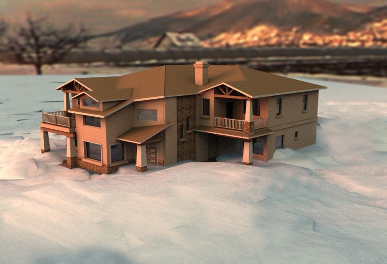

Today's study, an attempt to simulate, snow, shaft of light, HDRI probe called snowfield and finally depth of focus.
C4D is a real kick, I will work on this background model a little more and then I will post it so that you can drag and drop your ArchiCAD model into the snow field scene.
Snowed over by C4D r9.
Last study of this snow scene, I promise.

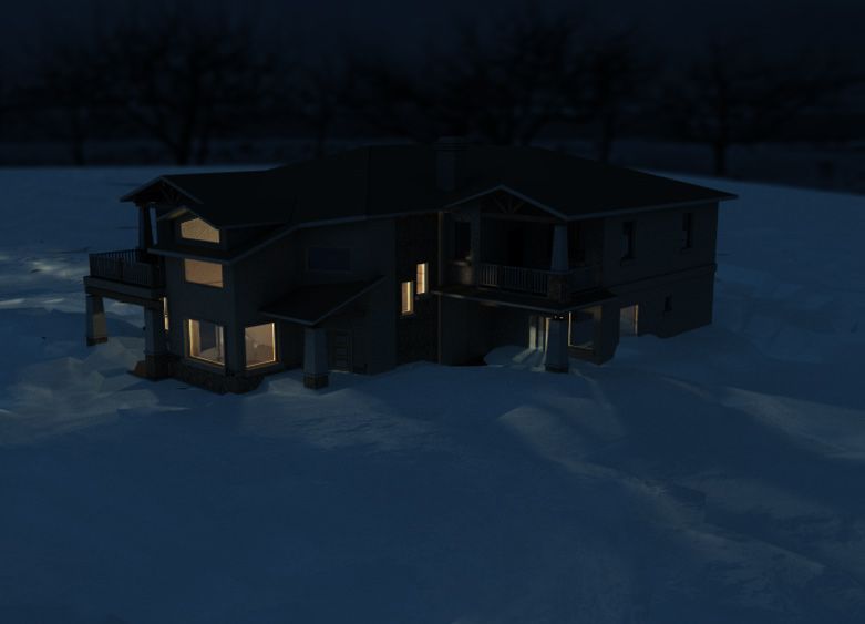

After trying to tweek the LightWorks sun, etc. etc. I became fed up with the results.
Simply exported the 3Ds format file, loaded it into the C4D r9 demo, corrected the sun position, selected radiosity and 5 min. later up pops this image. Then I used snagit to screen grab the image.
A quick in progress image for the client that I am proud enough to send. Created with a minimum of time, with a rendering engine that is basically free.
