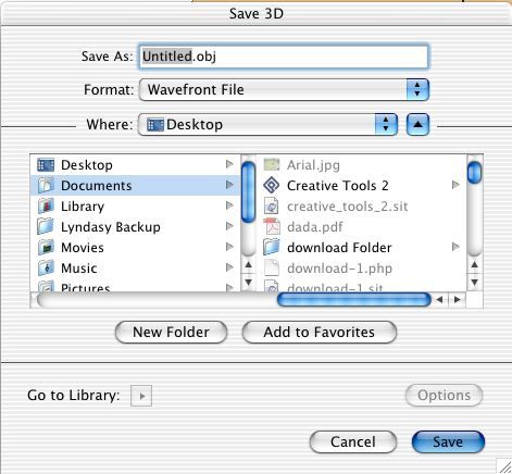

Recent C4D rendering.
This is the export method I use to get models out of ArchiCAD and into Cinema.
1. Save as Wavefront (.obj)
2. File Settings
Construct Group Hierarchy as: (Layers - Materials)
(Model Rotated)
Set Drawing Unit to: (1.00 inches)
This will bring the model into Cinema, and if you set the Cinema units to inches it will be at the proper scale.
I prefer to use Wavefront format since it support quads (model is made of four sided polygons, insted of only 3 sided = lower polygon count = faster rendering). I also find it easier to work with the model split into Materials based on the layer they are on. This way I have more control over texturing. Sure it requires a little more work to set up the model in Cinema, but It makes it easier to control materials.
