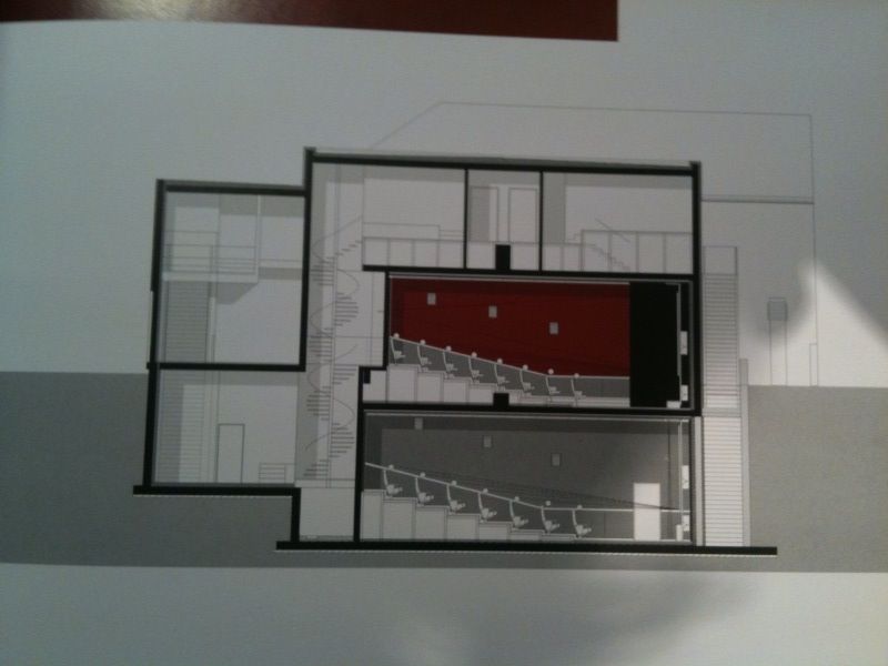

I want to achieve a section ' render ' to look something like the attached image ( from a book ). I've altered many, many settings in my section settings but I can't get the same look...I've tried changing the wall colour, vertical sun shadow settings etc. Also, my section takes around 10 minutes to update, even if I just change one line for example, similarly it takes around 10 minutes to update on the layout book, is this normal ?

Well the reason you're having so much difficulty duplicating that effect in ArchiCAD is because it is a fake effect; i.e. unless all those rooms are the same depth from the cut line, there's no way the shadows will look lined up like that.
That was just a person that used his artistic sensibilities (rather than whichever respective program's capabilities, that they were using, if any) to present the image in a manner that would not only be easier to read, but also conveyed an artistic sense of depth.
At some point you have to let go of just relying on the program to generate a good image for you, and instead lean on your own artistic intuition.
I produced the image below, using a combination of ArchiCAD's Sun shadows along with additional fills where they added some perceptive value and depth to the reading of the image:
Furthermore, sometimes the program simply can't give you the correct look or a clear enough image and you have to fill in all the blanks yourself.
The plans and images below were from a model I made in another program, and but which I had to draw in the shadows manually in AutoCAD/Illustrator
In a case like this where ArchiCAD would never be able to handle neither the model complexity nor the shadow calculations in a reasonable time, there's not other choice to get the required look. I guess what I'm saying is that at some point you have to not rely on the program or not rely on it so much, and start instead relying on your own artistic instincts and sensibilities.
If you insist on going the ArchiCAD route, then I would suggest 2 things or workarounds. Firstly, you might have to place your Sun at a very low altitude (almost zero degrees Azimuth or a few degrees above it) and behind your camera off to the side. That way, the shadows cast don't spread all the way down the side of the facing walls thus darkening everything. You might also want to place your cut line as close as possible to the facing walls to reduce the effect of the shadows, or if you can't the second thing you might have to do is to place a temporary wall just behind the cut line for the shadows to fall on, but not fall on it too low. The only problem with this is that you lose all the detail of the objects and elements behind the wall. In which case you can either do 2 sections one with the wall and the shadows, and one without the wall, and them comp them together in photoshop or illustrator.
There's actually a third alternative which involves making an identical cut of the model using the marquee tool and then from the 3D window with the view as Axonometric or parallel facing exactly the same way as your 2D section, generate the shadow using the Internal engine of ArchiCAD, and then "copy" the shadows from there, and paste them as 'Fills' in the section window which you can then manipulate easily like you would other fills and even hide if necessary.
As for you problems with the time ArchiCAD takes to calculate sections - turn off shadow generation option in the section setting unless or only until your really need it. I would stick with using the 3D window to generate the shadows and then just manipulate them in 2D as fills.
