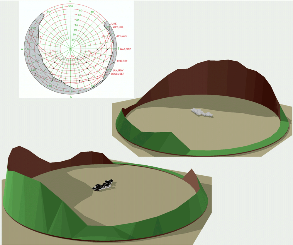

This is a bit hard to explain, but I'm looking for a simple way to model the "surveyed" horizon line (skyline) of a site, in order to run a more accurate sun study (i.e., has the sun set behind the mountain ridge or the building next door).
I built a cylindrical "mask" which follows the elevation of the skyline (from a site survey that graphs the angle and bering of the skyline). The elevation varies depending on the radius of the mask, but it's easy to figure out.
The best solution I've found is to use the mesh tool. Any better ideas?
Would it be difficult to create a GDL cylinder with nodes every 5 degrees, where one could dictate the elevation of each node?
Just wondering.

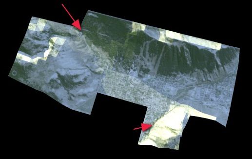

Attached is a zoomed out image from Artlantis of a site in Jackson, WY on a winter morning (as far as the sun is concerned - that green grass is just playing games with your mind!) The building site is at the lower red arrow.
The upper red arrow shows the morning sun coming through a valley to hit the site. I included only enough terrain to account for what would block the sun. In this case, I made things contiguous because of the importance of the valleys for morning and afternoon sun - and left town in just for context.
By zooming out like this, you can see better what I meant about the low polygon count from GE. This results in some pretty rectangular looking patches of illumination, and at times, fairly geometric shadows.

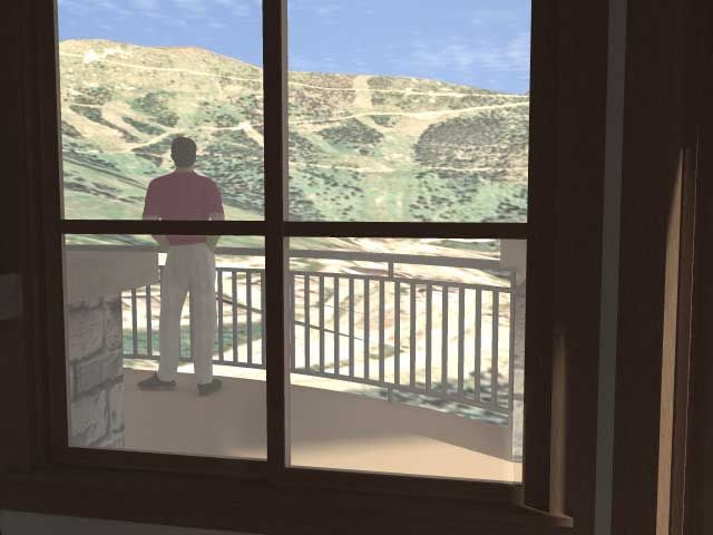

Here's one at Schweitzer Mountain Resort in Sandpoint showing the use for determining views and/or just giving a client a bit more realistic OpenGL walkthrough. Home design is by a friend, but I did the GE stuff for him.
