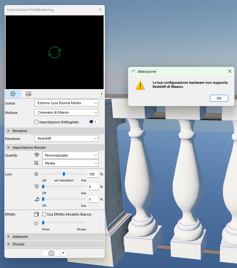

I would LOVE to know the answer to this since I am on windows 11 with and RTX5090 and cannot get redshift to work lol. Says my hardware does not support it...
ITS AN RTX 5090
Can you show the exact error message displayed when you try to use ther Redshift Engine in Archicad?

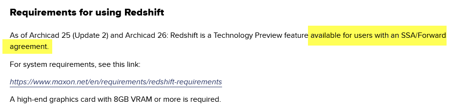

Do you have a current subscription?
From the help manual...

Hello,
to reply to @Laszlo Nagy
this is the error message,
for @Barry Kelly, I'm on Archicad Collaborate subscription plan, but as you pointed in the help manual page(Archicad 29 Help) is clear that the version of RedShift is based on the outdated Cineware 23 of Maxon(released on sept 2020), and the Blackwell cards(NVIDIA 5000) support starts from redshift 2025.5.0 released in June 2025(Redshift Doesn't Recognize my 5000+ series GPU (Experimental Support for NVIDIA Blackwell GPUs) – Kn...), so the question(about which the Archicad developers seem completely uninterested in answering🤣🤣) remain the same, is are there any plan to update Redshift?
