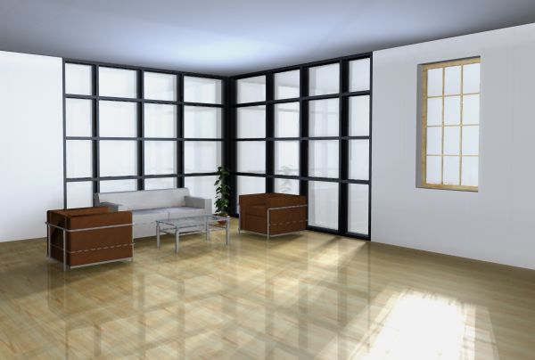

Hello,
I created this little scene and rendered it lastnight, I can't believe that a Lightworks novice like me can create such real life images so quickly.
Graphisoft has done an incredible job with 9.0 and lightworks.
Any comments will be greatly appreciated.

I believe in ArchiCAD 9.0 alone one can create a good realistic looking scene (Although not compared to other more sophisticated softwares like Max, Cinema 4D, etc), what one need in doing so is understand some basic principles, and tools that the software provide. We have to understand, for example, that Global Illumination is not provided in this software but we can simulate this and even radiosity using additional general light sources provided in ArchiCAD. Normally the scene will contain more that one or two lights to be good.
Here are my ideas for improving the Image:
- improve the camera to show clearly the furnitures and anything you want to show, the furnitures looks too far and are not seen clearly although there is a very big window just infront of them
- try to get soft shadows of the window frames, by changing shadow resolution and/or light intensity
- decrease a little bit reflection of the floor material
If you use window light on such window, ofcourse you will spend long time in rendering, but try to use other lights to achieve the same effect - only practice. You remember what Morpheus told Neo (in Matrix), 'I can only show you the door, but you are the one who have to walk through it' - so these are some ideas, so keep practicing and ask whenever you are stuck.

wr1nkles wrote:
also, what i would do, is increase the diameter of the bars on the chair to utilise your *chrome look in your image* However, i do not know if this would look out of proportion in contrast with the chair body itself

Here's the room Layout.
Here's the sun object settings... I will say this, it really make a difference what degree the Azimuth is. I have it set at 300 in this scene, but if I were to move it only by 10 degrees the scene and lighting looks completely different.
I'm sure Dwight can relate this fact somehow to Photography, which by the way I'm starting to appreciate when it comes to lighting. Most of his tips make complete sense when he makes photographic parallels...
Here's my window light up to ceiling settings.
Last but not least here's my window light down over furniture setting...

I'm being very bad by reading and not working ... so a quick comment:
The sun setting in your screenshot show that it is giving off blue light. Try yellow ... reserve blue for your sky object.
Also instead of white on your fill lights, try something warmer ... the radiosity off the floor and furniture combined with a warm (low) sun would provide some color, right?
Thanks for posting in such detail ... it will make this thread useful to many!
