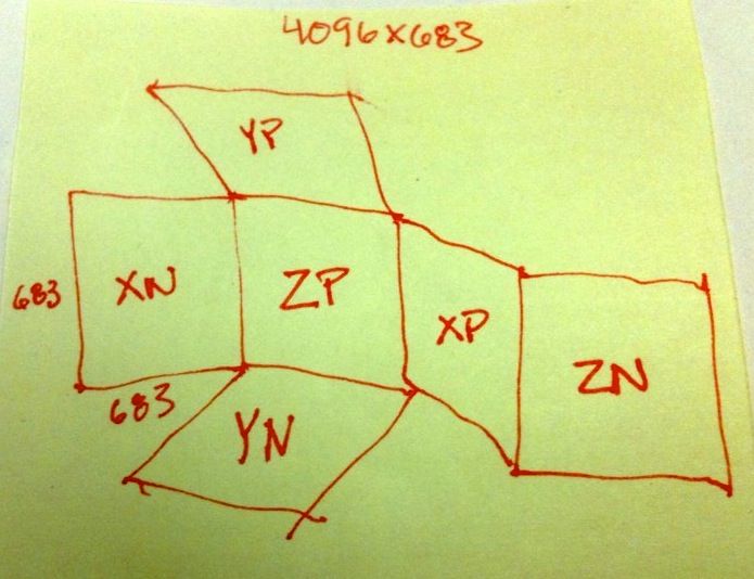

1. Find a good 360 degree cube map of a sky online. A good source I found was cgtextures.com. There you can get a single image of a cube map which is six sides of the cube, but all in one long horizontal image.
2. Crop and save the individual sides of the cube map and replace the images that come with VBE. The file names tell VBE where each image goes so they all get stitched together correctly. Attached is a diagram of how I deciphered the faces of the VBE cube map.

[NOTE: for some reason I had to flip each image of the cube map (flip vertical command) so they would stitch correctly. I'm not sure why because the original images that came with VBE are oriented with the sky up. Mine are sky down, but appear sky up in VBE...whatever.]

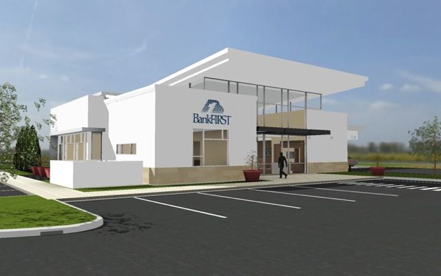

Before
After
Karl Ottenstein
Moderator Emeritus
Fantastic result, Eric - changes the whole atmosphere (pun intended) of the image - especially with the added info in the distance at the ground line. Looks rendered ... and must make the VBE experience much nicer.
