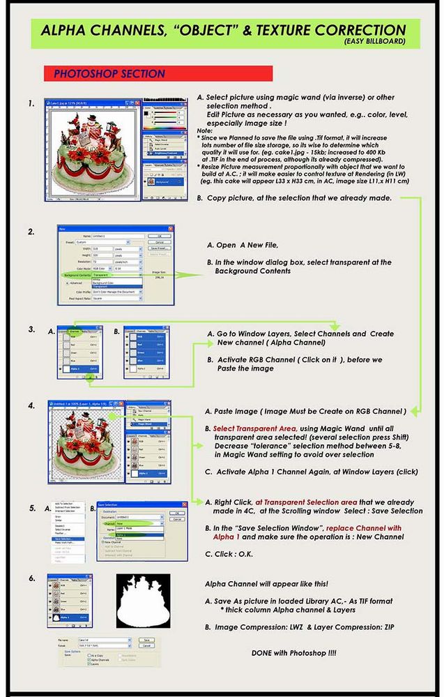

Photoshop Section tips: Creating Alpha Channel (Part 1)

Tips Texture Correction in Lightwork Rendering: (St. Layout Is the Answer) AC9 User
Users of Archicad 10 should note that when "Matching Internal Engine," to transfer texture map information from the Internal Engine to the LightWorks Engine, that the transfer bug inverting the texture map in Archicad 9 has been fixed.(Dwight Atkinson)
