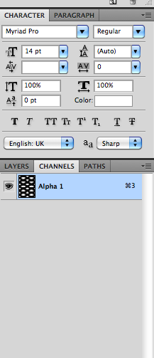

Show me the channels.
What file format is the image?
Dwight Atkinson
Its a .tif file.
I'm assuming there needs to be more channels as I only have one... ( greyscale ) ?
Thank You
What else could be causing the problem... Still not managed to get it working.
I've got it working - Here's a screen-capture of the material (surface settings).
