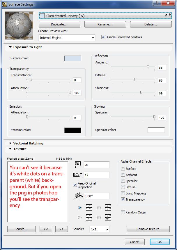

I'm assuming there needs to be more channels as I only have one... ( greyscale ) ?
Thank You
What else could be causing the problem... Still not managed to get it working.
I've got it working - Here's a screen-capture of the material (surface settings).
I'll post the actual 'polka-dot' files next
Polka-dot file below. The PNG file format allows for transparency without being as bloated as a TIF. It's white dots, with a transparent background... which is white, so you'll have to trust me - it's there.
Just right-click and save as...
Looks like it's set up to tile easily.
