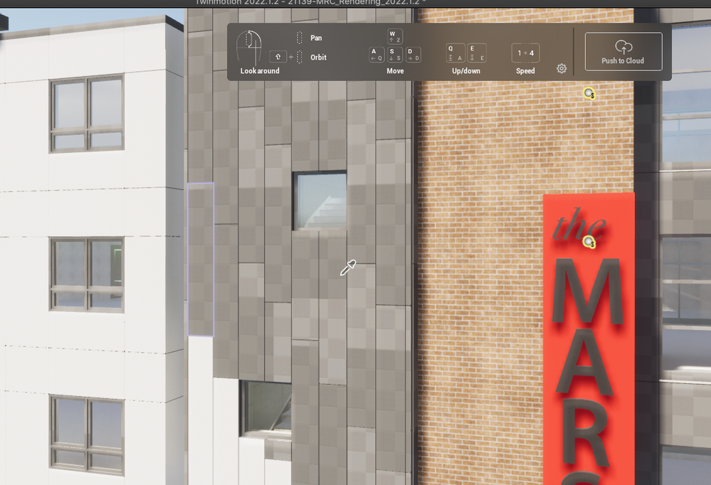

I'm in the same boat as you with Archicad 24 and Twinmotion 2022.1.2. Have yet to find a solution and now discovered some materials aren't even editable.
