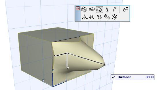

Realtime shaded feedback for morph editing.

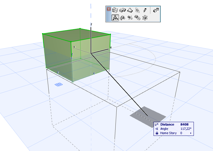

Surface snap rectangle feedback to the cursor and rotation feedback for 3D (and 2D floorplan as well).

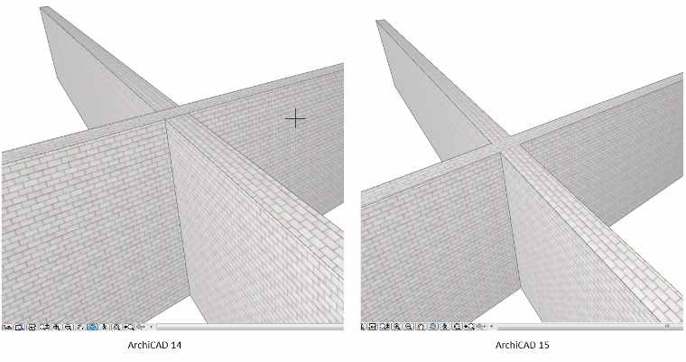

3D Line elimination is implemented in 3D window. This is used in case of overlapping lines, by removing the unnecessary. This worked in internal engine prior ArciCAD 15, from now on it is available with the OpenGL engine as well.

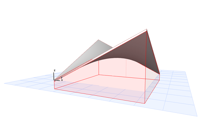

Trimming Bodies for the new Shell and roof tools are generated by OpenGL engine. This way it is possible to see and set the size and direction of the highlighted cutting body.

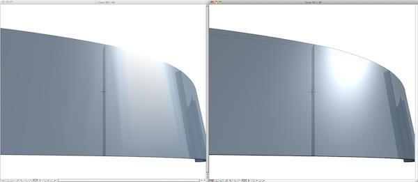

Since version 14, ARCHICAD uses Per-Pixel Lighting which gives a much more realistic result. (see image below - on the left is ARCHICAD 13, on the right is ARCHICAD 14) This feature does need more video card power, but according to our tests it causes a slowdown of 20-30% which should not be noticeable if your card is powerful enough. (as long as the frame per sec rate is above 30, you can not really see a speed difference).
