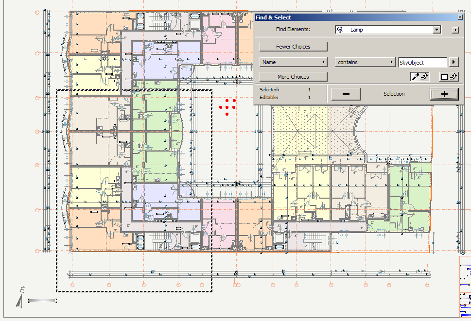

1. Place the SkyObject on the ArchiCAD layer. Define pen 91 for its color, plus Send it to the back so it won't cause trouble in your views and when printing. Show it on all layers. This way you will always have the 'invisible' SkyObject available for you.
Now, the next problem is to know if the SkyObject is included in the Marquee when you want to generate a 3D View.
2. For this, Save a Criterion in the Find & Select dialog as show in the first attached image. It will find the Sky Object for you.
Then zoom to show all. Place the Marquee. Go to Find & Select. Load the Find SkyObject criterion. Find the SkyObject and move it within the Marquee as needed.
2nd screen capture to my previous post.

laszlonagy wrote:
Here is a not so dreadful workaround.
1. Place the SkyObject on the ArchiCAD layer. Define pen 91 for its color, plus Send it to the back so it won't cause trouble in your views and when printing. Show it on all stories. This way you will always have the 'invisible' SkyObject available for you.
Not so dreadful at all!
OK, now I agree with my colleagues: this workaround should be a Tip or on ArchiGuide! πŸ˜‰
Thanks!
Karl
