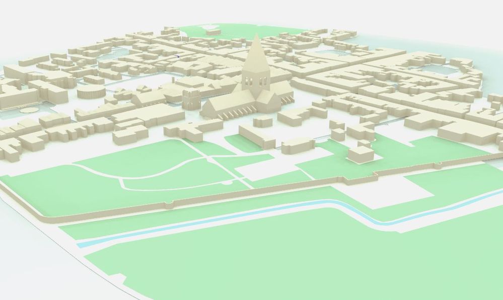

I'm currently modeling an urban site for a university project and am having trouble with the renders. I would like the site model to be nice clean white as if it was made of white card or something similar. At the moment when it renders it looks a little grey in many areas. Any ideas?
Thanks in advance,
Mark

‎2007-02-22 09:38 PM
Seriously, big improvement
P.S. You might also try "sunset, sunrise color" switch ON in SunObject settings, sometimes it gives interesting results.
P.S.2 Remember about Brightness slider after rendering is done.
P.S.3 I couldn't help myself and mess with your rendering.

‎2007-03-01 09:17 PM
- decrease ambient light
- take a bit from skyobjects and give a bit to sunobject for better shadows
- make your grass less colorful and more dark
- use afterrender brightness setting to improve contrast
Thats all.

Many Archicad users without photo editing fight with Archicad to render with correct color and exposure when ten seconds adjusting "Levels" or "Shadows/Highlights" in an application llike Photoshop can prevent another rendering.
Mostly, renderings lack a full range of values since Archicad's rendering engines play it safe, avoiding white and black. Adjusting levels expands these values to have greater impact.

This adjustment lives in the PhotoRendering Dialog. It is dangerous.
The Brightness Slider does not reset. I have learned the hard way that if the Brightness dialog collapses, the user can forget they made an adjustment to correct a bad exposure and the setting stays, hidden and forgotten. Then, next time, what were properly-exposed images look bad. When this happened to me, I spent a lot of time re-adjusting lights when it was the forgotten brightness control.
Danger.
