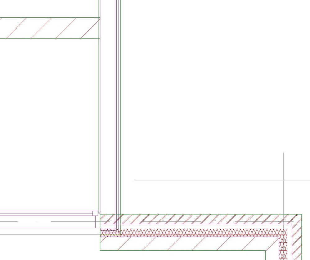

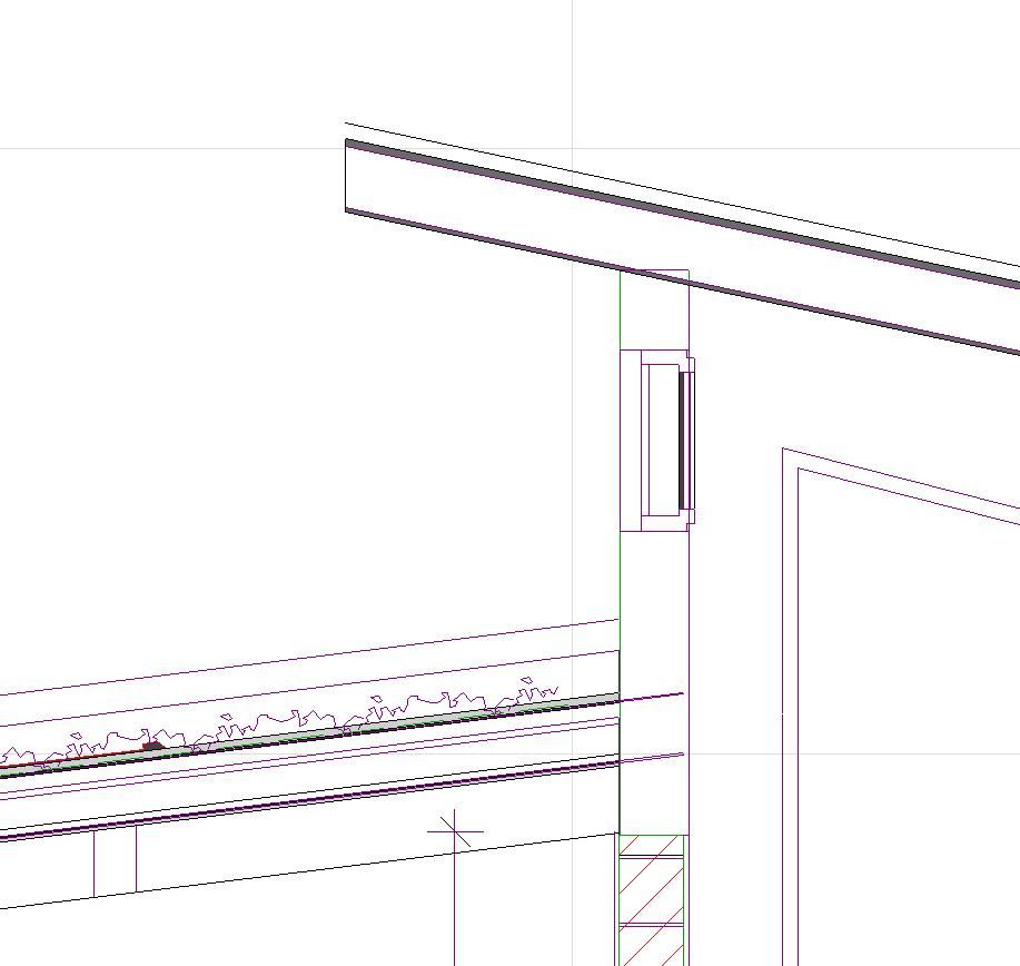

heres screenshots, you can see the wall displays the skin separators on plan, but not on section (it is the upper wall on the section with a window in it)
heres the plan

You may have "core only" selected in your partial structure display options... Open your "quick options" palette and check that.

Percy,
If your plan is showing correctly? then I suspect you have the same fills adjacent to each other in your composite wall. (your example looks like an empty fill) Archicad will automatically join these in sections. Just change fill types between adjacent skins. If you don't want a fill pattern then save an empty fill with another attribute.

If it is correct in plan then it should be correct in elevation as well.
I would be guessing that Percy is using the view map to change between plan and section.
The Model view Settings must be different in both.
The "Show skins separator lines" might be turned off in the section.
Or maybe I have misunderstood what is happening.
