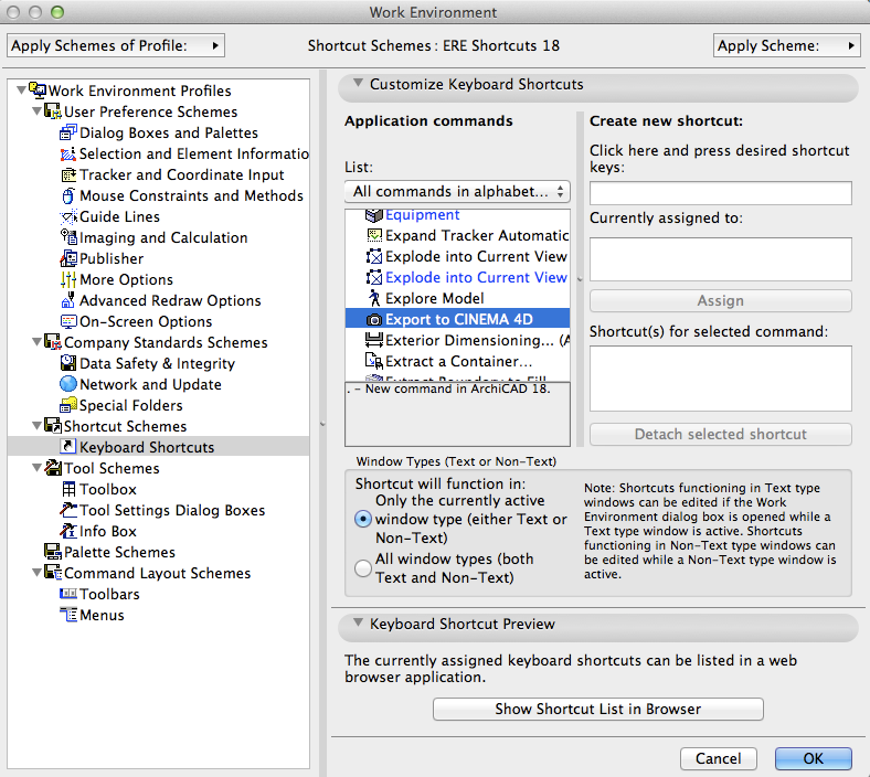

I've just upgraded to AC18 from 12, so have a lot of things to catch up on. I was motivated by CineRender, and the possible link to C4D.
However, I'm having trouble finding out how to export to C4D. The Reference Guide says, "If you want to continue working on your model with additional Cinema4D functions, use File > File Special > Export to Cinema 4D." But, there is no such command at that location (v. 3006 USA FULL), regardless of what window I'm in; plan, 3D, or render? Is there some switch somewhere, or an add-on required?

I thought the recently downloaded version would have been current. I am now up to date. But the problem persists. No "Export to Cinema4D"? No Cinema4D in "save as" anymore, either? I also checked the add-on manager, and everything is on, but no mention of C4D?
I did let 18 load in default work environment, although I'm working on editing to my preferences now.

Hi, Check that the 'Export to Cinema 4D" is available in your work environment. If not, perhaps a reinstall using the repair feature.

I did finally find and install the Cinema4D exchange plug-in from the ArchiCAD website.(Thought it would have been in Goodies package?)
"Export to Cinema4D" is (now) in the work environment menus.
And it appears in the "Save As" file options, so I will go there when I have some time.
Still didn't appear in the File Special menu as mentioned in the Reference Guide, so not sure if this is the most integrated version.

In case anyone else is following this, I subsequently found this information for "CINEMA 4D Exchange" in the Add-Ons Manager.
This add-on exports CINEMA 4D files with extra information for ArchiCAD objects, and merges back the modified CINEMA 4D data to GSM objects. So you can simply make renders with CINEMA 4D or create organic GDL objects for your project.
Locations in the user interface:
Design / Design Extras / CINEMA 4D Exchange
Open / CINEMA 4D File
Merge / CINEMA 4D File
Save as 3D / CINEMA 4D File

Hello Doug,
Probably, you've already found the "Export to Cinema 4D" command as well but for those who didn't read the below article yet I want to mention that the location of the "Export to Cinema 4D" command is at the drop-down menu next to Render button on the PhotoRendering palette.
