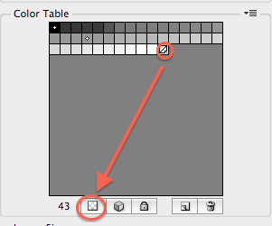

Often, an easier way than magic-wanding/non-contiguous in Photoshop, or at least an alternative, is to use the Save for Web dialog to mark a color table entry as transparent. This is possible with both PNG 8 and GIF. In the attached, image, you would click on the white (or other background) color and then click on the 'make transparent' button.
Cheers,
Karl
