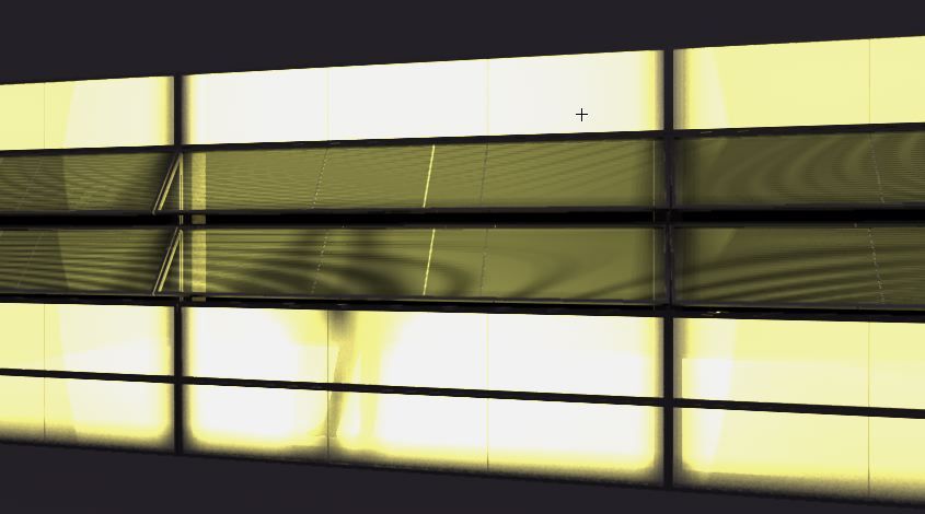

__archiben
more....
looks kinda funky but not really right. this one uses the transparency + emission idea, but i think i stuffed up refraction . . .
i don't want to 'see' the slab bulkhead or the columns as clearly as i do. but the people shadows are about what i want. could be softer.
~/archiben
b e n _ f r o s t
Dwight
have you considered a second scrim behind the facade?
but you'll probably never get the differential od seeing the figures sharper than the back wall.....
