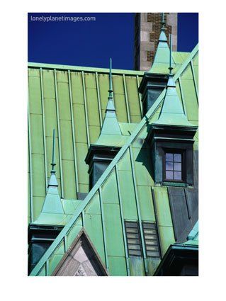

How are people on this forum creating vertical seam metal roofing? Modeling or just texture?
If only texture is there no way within Lightworks material editor to have two colour shaders? That way I could have one to create the seams and another for the material colour (aged copper in my case) while keeping the material “procedural” instead of going for an image map.
