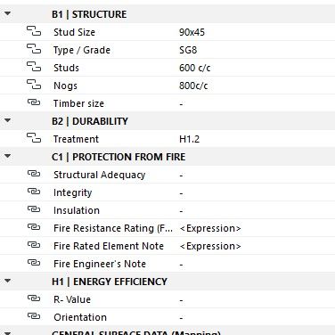

With expression-based properties, it is possible to extract and combine parameters (including other properties) to form a string.
For example, I have properties related to timber framing like studs, nogs, treatment, grade, etc.
I have an expression-based property that determines if the wall is of timber construction then combines the above, plus other parameters (composite name etc) to form a note (sentence), if it's concrete, then a different note is formed. This is then used/displayed in a key (Interactive Schedule).
This works really well. However, one limitation is that users, in the key / interactive schedule, can overwrite the expression-generated string with manual text. This appears correct in one instance, however, all the underlying parameters still have the original data/parameters.
While I have several Graphic Overrides that look for these properties with custom values, there's still a risk.
My wish is that somehow there is a way to to lock expression-based properties.

I have used expression-based properties, to combine (Concat) various properties (Option Sets, Strings etc) and text, to form a note.
I have used sequences, to create variations of the above, to be used with different structure types.
My actual setup is a little more involved than below, as I have another method using expressions to show/hide the renovation prefix (New/Existing) depending on the type of project.
https://community.graphisoft.com/t5/Documentation/Property-to-determine-if-a-project-is-a-new-build-...
There are also a couple of other bits where a particular naming property can override the expression.
The below thou is an extract that generates the key as shown in the previous post.
The expression has two sequences (Line 1, Line 2).
The idea here is that if the first parameters aren't met, it goes to the next.
That's how the timber walls show framing details, while the others don't.
Line 1
(Concat(Stud Size, " ", Treatment, " ", "(", Type / Grade, ")", " ", (SplitRight(Name / Building Material / Complex Profile, "mm ", 2)), ", with ", "Studs @ ", Studs, " and ", "Nogs @ ", Nogs))
[The split right function is used as our Composites are written like this "90mm Timber Framing", the 90mm is the overall thickness which I don't want. I just need the text after the "mm". Our key shows the stud size 90x45, not the overall wall thickness. So split this property, at this text, show the 2nd bit of the split, not the first]
Line 2
(Concat(Name / Building Material / Complex Profile))
This property "Name / Building Material / Complex Profile", just uses sequences to return either the Complex Profile, Composite Structure, Building Material, or Classification Name (failing all else) of the wall.
