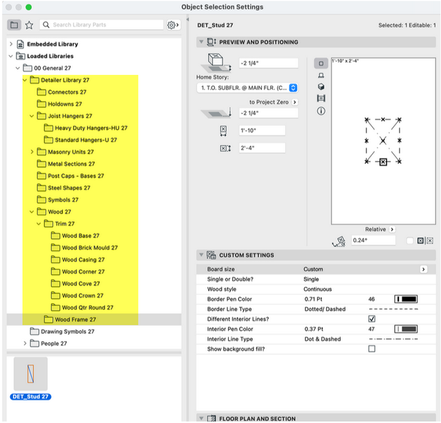

I loaded the legacy objects and I have some problems:
1. If this is a LEGACY object, why doesn't DET_Stud have the same GUID as DET_Stud 27? I have 429 instances of that object in our template, 95% in hundreds of details. I need to go to every single detail and manually change them one by one. Injecting properties doesn't work, since they have different settings + the orientation is different, so after injecting, the stud moves to a different location. This is very frustrating.
2. Why is this legacy? What does Graphisoft offer that is better and more up to standard? I don't like loading legacy libpacks to a template.
3. How is it better to load this Legacy libpack than creating a Detailer package with the 27 objects used? The term "legacy" doesn't sound like it's going to be cared for in the future, so how is it better than the 27 objects? All I see is days of work transferring to something that is already suggested to be obsolete.
"Fixing" 700+ details is going to be fun...
Graphisoft should at least offer smarter search and listing options across full project (details, sections, layouts etc.) I have no idea where objects are if they aren't in the model space. (Is there a wish for that?)
None of the 28 library packs are backwards compatible with 27.
In other words 27 objects will not migrate to 28.
I don't use it, but I assume even the legacy objects pack is a 'new' library with new GUIDs.
It is the same old objects but saved with new GUIDs.
I guess it is 'Legacy' because Graphisoft no longer want to maintain these objects and want you to use the new library objects?
I really don't know.
If you are opening an old file, just keep using the old libraries.
If you are opening a new file based on a 28 template, then use only the new global libraries.
And if you really need these particular library parts, then load the legacy global library pack, and don't worry about the fact they have called it 'Legacy".
