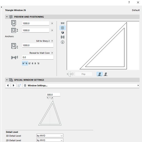

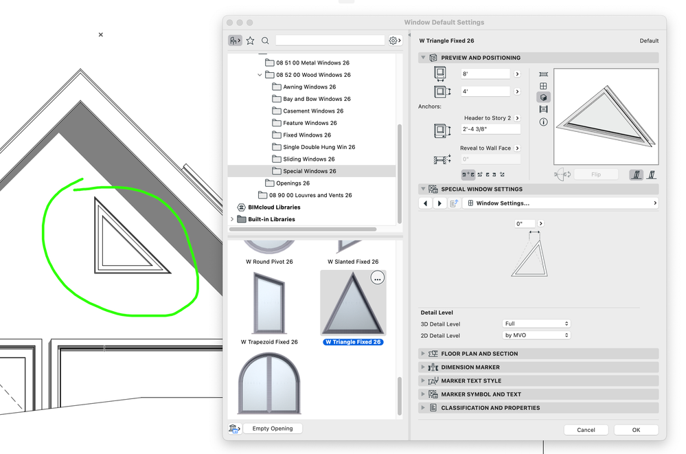

How is it possible that in 2022 / Archicad 26 there is still not an out of the box right angle window? The Triangle Fixed window [Moderator: in the USA library] can not have a vertical side. This is super annoying. The only way to achieve this basic window shape (without paying for a 3rd party window like Cadimage) is to use the ancient FreeFormWindow, which is missing tons of features and is surely going to stop working at some point. Can whoever is in charge of the libraries, just spend like 5 minutes and get us this window?Screen Shot 2022-11-16 at 9.45.53 AM.png

It is pretty weird for sure after all these years! The parameter shown in your screenshot for the location of the peak can be adjusted vanishingly close to ½ the window width to approximate a right angle window in a pinch for preliminary design work.  Depending on the scale of the drawings, it might be enough to fake CDs.
Attached, I dragged the closest approx to a right triangle to the edge of a wall to show the small (approx 1/4" for a 40" wide window) gap showing in the stucco due to the inability to set the top vertex exactly above the bottom one.  I turned on casing to make this really obvious. The fact that they disallow two vertices from occupying the same X coordinate position (per se) tells us that the mathematical construction method used would have to be changed to allow this to be a more flexible window... so I'd guess it is more than 5 minutes work, but work that should be done nonetheless.
It's so frustrating to take that top vertex to 1/2" then 1/4" then a 1/16"... so close to zero and yet, nope! I agree for SD, it's probably fine. But I refuse! 🙂

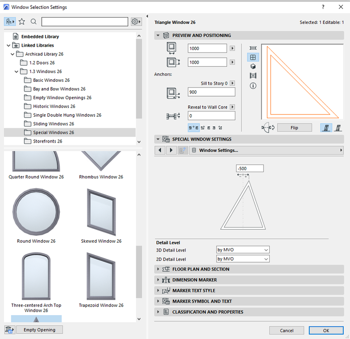

Maybe it is an imperial thing. I just checked in the INT version and I can get a right-angle triangle window from that exact object.
I do not have the words to express how ridiculous this is. In the USA library, we can not do that.
Yeah, when I saw your post I had to test it to see. And to think that it doesn't work in the US library is really disappointing, to say the least.

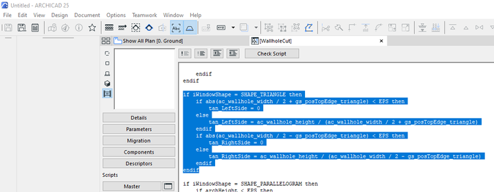

AllanP
in the Australian library that ships with Archicad 25, it works,
but way back in Archicad 22 it was still broken.

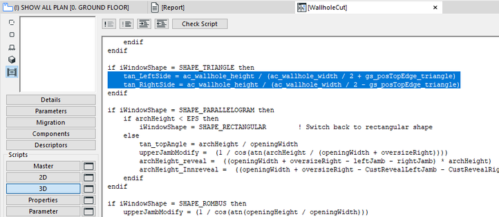

the offending lines of script are divide by zero for the triangle window
add an exception for divide by zero that has been added in the Australian library for 25/26
line 443
if iWindowShape = SHAPE_TRIANGLE then
    if abs(ac_wallhole_width / 2 + gs_posTopEdge_triangle) < EPS then
        tan_LeftSide = 0
else
    if abs(ac_wallhole_width / 2 - gs_posTopEdge_triangle) < EPS then
        tan_RightSide = 0
else
and a bit futher down find any other lines that mention
There are only 5 short groups of script that are for the triangle window
and add exceptions for divide by zero
line 876
if abs(tan_LeftSide) < EPS then
    _oleft = 0
else
line 886
if abs(tan_RightSide) < EPS then
    _oright = 0
else
line 1437
    _oleft = 0
    _oright = -rightJamb / sin(atn(tan_RightSide))
    _xTop = 0
    _yTop = (ac_wallhole_width + _oright) * tan_RightSide
else
         _oleft = -leftJamb / sin(atn(tan_LeftSide))
        _oright = 0
       _xTop = ac_wallhole_width + _oleft
       _yTop = _xTop * tan_LeftSide
   else
line 5387
     _oleft = 0
     _oright = -offRight / sin(atn(tan_RightSide))
     _xTop = 0
     _yTop = (sideLeft + sideRight + _oright) * tan_RightSide
     px1 = (sideLeft + sideRight) / 2 + _oright - (offBottom / tan_RightSide) * not(gs_stack_bottom)
     px2 = -(sideLeft + sideRight) / 2
else
          _oleft = -offLeft / sin(atn(tan_LeftSide))
         _oright = 0
          _xTop = sideLeft + sideRight + _oleft
          px2 = -(sideLeft + sideRight) / 2 - _oleft + (offBottom / tan_LeftSide) * not(gs_stack_bottom)
     else

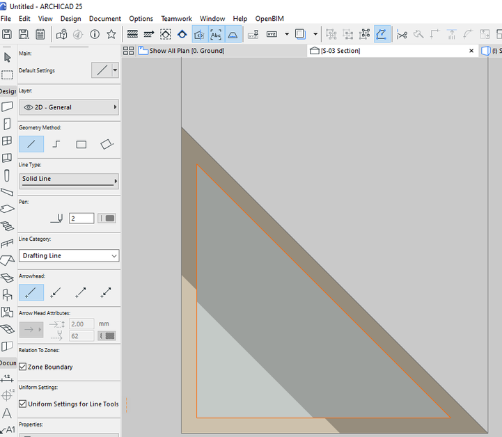

standard window in GER lib.
Erwin Edel
Rockstar
Is this some sort of imperial problem I'm too metric to understand? You can even over shoot the 90° mark in the Dutch library.
