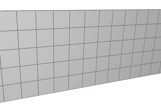

You can do that but it is a little awkward to do, if you place a small object on the floor plan at the point you need the texture to start from then select the wall & the object, Let's say a small column of about 10mm x 10mm height or sizes is not really important just position, next select the wall and the object & view it in 3D, then select the wall  then select the document menu, creative imaging, align texture, set origin and click the edge of the column, the texture will then move to that position, I have it setup as a keyboard shortcut shift O as I use it all the time, one really good feature is it also sets your vectoral hatching so say you have tiles on a wall & you want to set their origin point on the centre of a basin, this will move this as well so your elevation will be correct, I have attached some images to let you see what I mean.
Regards
David
