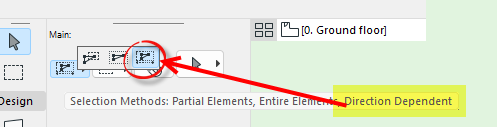

Another handy improvement, in my opinion, could be the selection “get everything inside / get everything touched” depending on the direction of the input, like in Autocad (or in SketchUp if we are allergic to Autodesk). Why not?
We already have that option for selection.

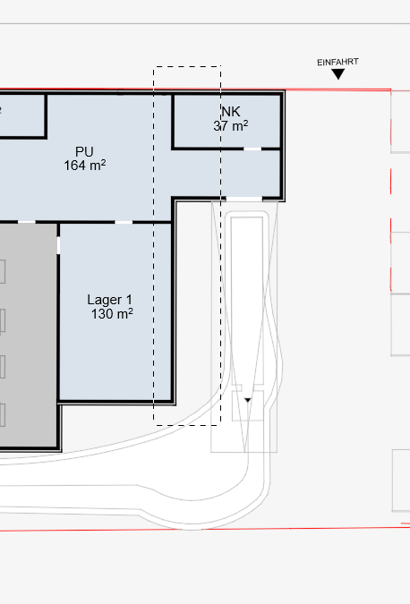

let's assume i need to move a piece of the wall... (3D Walls, Zones, 2D Elements):

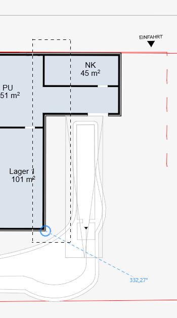

ac_before.pngI select the thing with my marquee. Then I move it 200cm to the left: ac_after.png
Oh, my truck moved too and the borders have as well. In autocad i would simply deselect those objects after the primary selection and before going through with the action; in archicad i would need to lock everything around beforehand, and then be really precise at the selection. The locking and unlocking also breaks if I have other, more important objects already locked away (for various reasons).
Also, I could move these few objects by the same amount back, but what if i don't move by specifying distance, but by graphical references? how would I find the previous line?
This doesn't help in all situations, but you don't have to use a rectangular marquee.
You can use an irregular shape marquee to go around the truck and borders (if possible), so they are not included in the stretch.
It is not always possible to get around some element, so locking them or their layer is the only way not to include them (or temporarily hide the layer).
