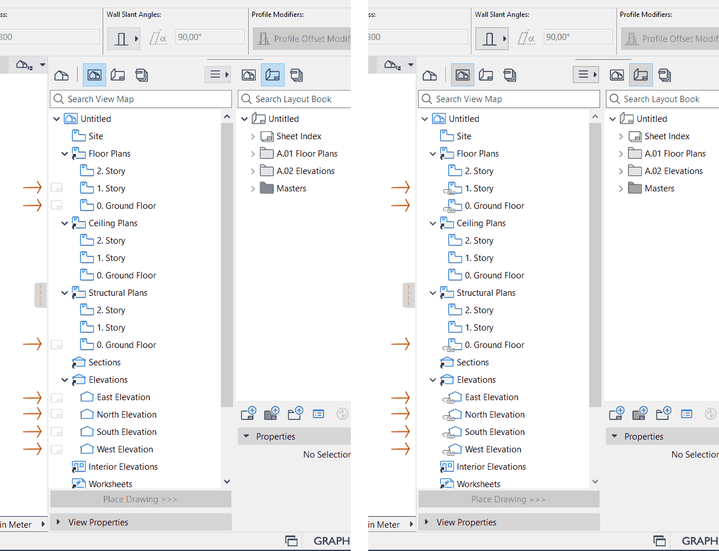

When there are a lot of views in the View Map, it would be nice if ArchiCAD somehow marked views that are inserted somewhere on sheets or simply intended for publication as views.
Thanks to this, a user cleaning the View Map would not accidentally delete such a view.
All you need is a small symbol next to the view, for example a gray Layout icon in front of the View, or a gray paperclip icon, or something else...:

I won't deny that Graphisoft's solution in Ac29 on this topic disappointed me. 😞
Filtering and marking unused/unused views on View Index?
It's like "holding your left ear with your right hand behind your head" 🙂 to simply QUICKLY check whether a view is placed on layout or added to Publisher Set.
I advocated for simple, intuitive/graphical/visual information in the view navigator (some kind of marker next to "published views", etc.). That's all!
Okay, filtering unpublished/unpublished views on View Index will probably come in handy someday, but how do you example filter the list (and then mark them in the Navigator panel) that meet logically related criteria, e.g.:
- views placed on layout AND added to Publisher Set?
- views placed on layout OR added to Publisher Set?
- views NOT placed on layout AND NOT added to Publisher Set?
etc.
...not to mention that reasonable Archicad users would use a template. Templates by default would have plenty of unused / sample views by default...
